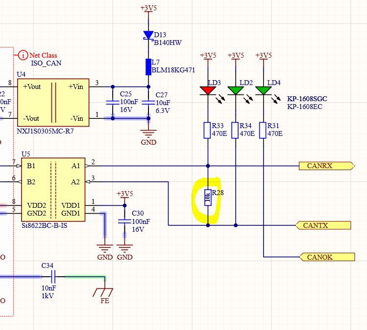

2022-07-11 3:08 AM
Whether the USB cable detection triggers depends on the isolator used.
With an Is8622BC it works fine, with ADUM1281ARZ it doesn't work.
It sounds ridiculous but with a resistor between the CAN1Rx (USB-DM) and CAN1Tx (USB-DP) it works fine with both, Is8622BC and ADUM1281ARZ.
I have reworked 10 PCBs, all working fine.

2022-07-11 4:32 AM
None of the PCB's communicate through Usart3 in boot mode. I send 0x7F, there is no response.
Until you desolder U5, R33 and R34 (connected to CAN/USB port)
