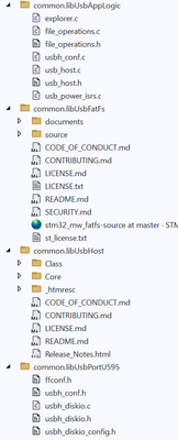

To summarize, the resulting structure, including the libs is this:
the first and last folders are where I touched anything; the two middle folders (fatfs & usbhost), are unmodified. The cube generated folder sits parallel to these four folders but I didn't include that here because it contains some proprietary folder names.
AppLogic is somewhat chip agnostic, I've tried it on three flavors of chips; whereas the Port folder (which contains some headers) is what has to be tweaked for each micro. -- i.e., if you're highspeed, fullspeed, the name of the typedef Cube made for you, and so forth.
