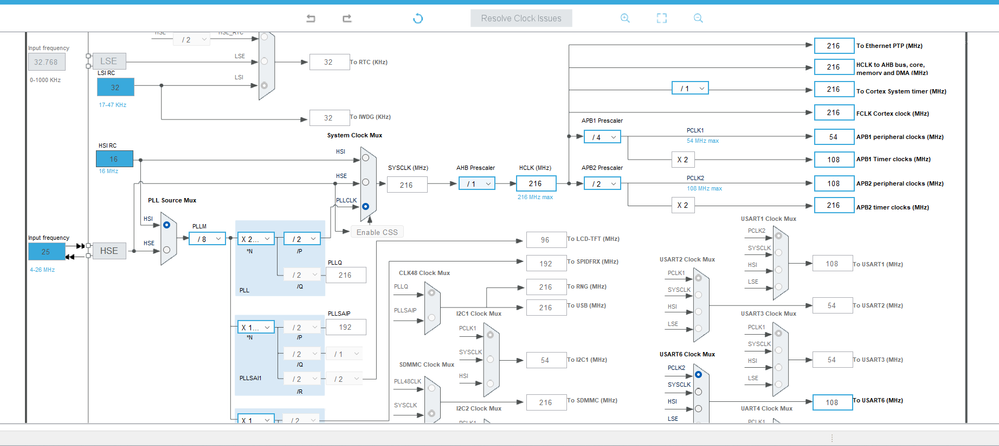

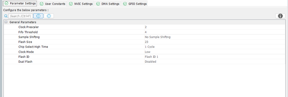

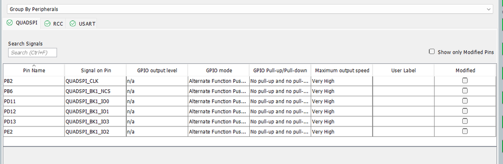

Has anyone successfully used the MT25QL128 with the STM32F746 Discovery board
Are there any known issues or adjustments needed when using the GitHub reference driver?
Could this be related to QSPI timing or clock configuration?
Is an explicit command like enter quad mode required before initialization?
I'd really appreciate any pointers or suggestions from those who’ve worked with similar setups.
