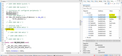

2024-08-08 6:58 AM - edited 2024-08-08 7:00 AM
Hello @Bangou_boy
I checked your code on the STM32F030RB Nucleo board. The I2C peripheral is well initialized as expected, and the execution didn't crash while listening IT. Please verify your setup.
Below, you will find a screenshot of the content of the CR1 and CR2 registers.
