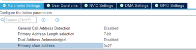

2024-08-02 7:31 AM
Please check the slave own address; it might be set incorrectly.
2024-08-02 7:51 AM
I set the slave own address

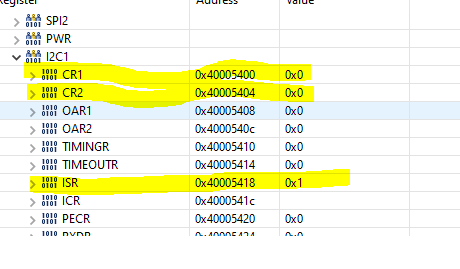

Hello @Bangou_boy
Could you please share with us the content of the CR1, CR2, and ISR registers after I2C initialization?

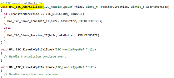

Hello @Bangou_boy
Does the HAL_I2C_AddrCallback() function get called?

2024-08-06 4:19 AM
Hi @Saket_Om
THank you . please find attached an screenshot of the CR1 CR2 ISR
Yes the HAL_I2C_AddrCallback() function get called.

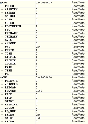

Hello @Bangou_boy
Is the value of the register taken before the callback gets executed or after?
I ran your code on my side and obtained the value of the CR1 and CR2 registers after enabling listen IT. Please see the screenshot below.

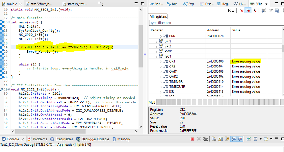

2024-08-06 10:12 AM - edited 2024-08-06 10:49 AM
@Saket_Om when i debbug it stop at this point , it seems it didn't run the the Enablelisten_IT other it run it but didn't whrite anything in the CR regsister look like yours. Anyway the debbug stop at Enablelisten_IT
