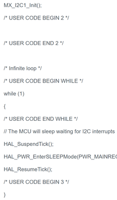

while (1)
/* USER CODE END WHILE */
// The MCU will sleep waiting for I2C interrupts
HAL_SuspendTick();
HAL_PWR_EnterSLEEPMode(PWR_MAINREGULATOR_ON, PWR_SLEEPENTRY_WFI);
HAL_ResumeTick();

You have to call HAL_I2C_EnableListen_IT to start the listening process. Probably should not enable low-power modes until you get the main program working. Work in steps.
2024-08-01 3:01 PM - edited 2024-08-01 3:04 PM
I enable the I2c to listen on the bus
I've disabled low power mode but it still doesn't work!
