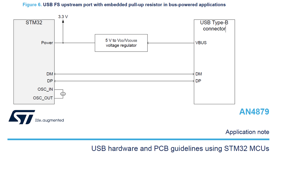

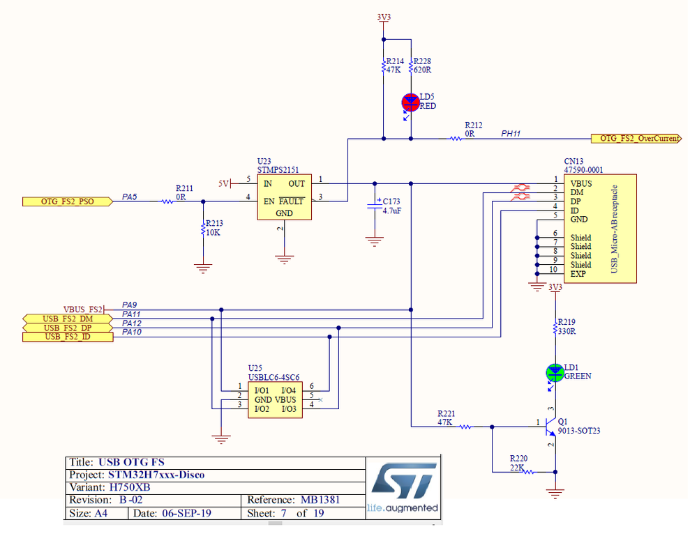

Please note my hardware design background is weak. I'm confused between the design in AN4879 and the schematics of STM32H7xxx-Disco, as shown below. Your help is much appreciated.
2022-10-15 2:04 AM
The upper picture shows the simplified diagram of a bus-powered USB device; the bottom one - dual role host/device without device bus power capability (but capable of supplying the attached device when taking the host role).

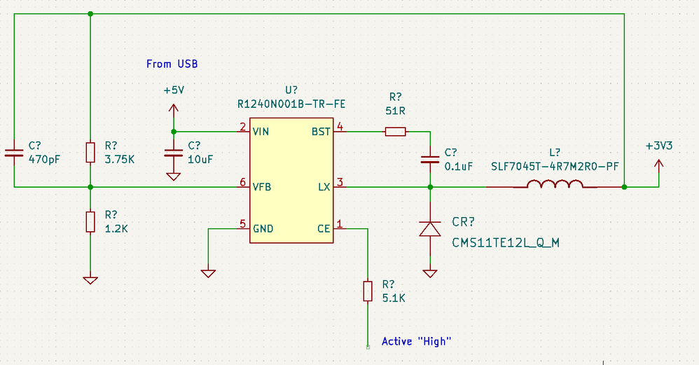

Thank you @gbm , Please advise the attached schematic is good for USB_OTG_FS , Communication Device Class (Virtual Port Comm).
2- In selection of a step-down converter, must the datasheet explicitly states in the Application "USB Power Supplies"?
