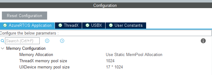

Hi @MDeva.1
Normally you should use the the "static memory allocation" as suggested by STM32CubeMX Config UI.
if it is the case in your project then do not modify the flash.ld file.

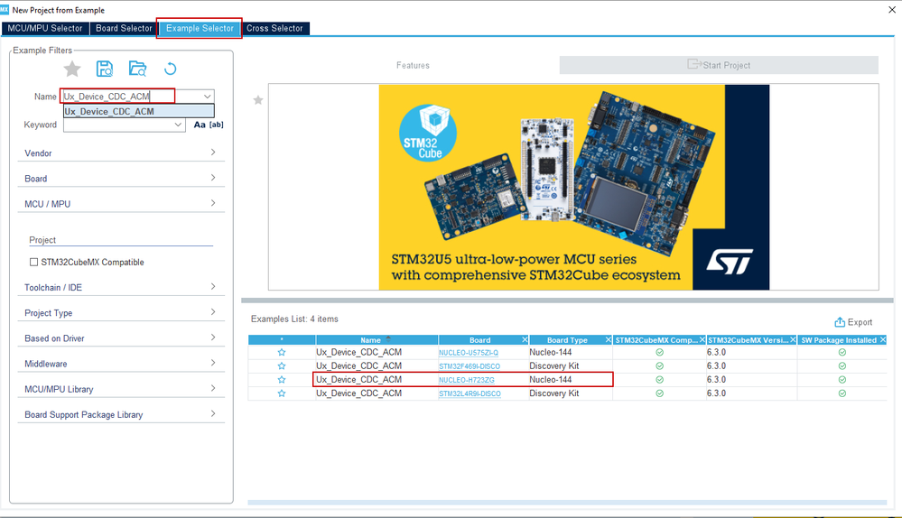

you can use the "Example Selector" from STM32CubeMX to inherit the UX_CDC_ACM application for the STM32H723-Nucleo board, then you can use it as refererence to configure your own project for the STM32H745i.
regareds
Haithem.

I am using this example that you mentioned according to that i making the configuration. But i get this error Break at address "0xa05f0000" with no debug information available, or outside of program code.And when i connect the two usb my user usb port is not get detected why this happend ,according the setting is done in UX_CDC_ACM this example accordingly i make in my project.
Also accordingly I set the MPU base address.Then why this error is come? can you helpme.
