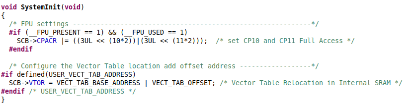

2023-08-31 4:45 AM
Hi @gbm correct me if I am wrong. SystemInit() is used to set the vector table and has nothing to do with clock configuration and SystemInit() is called in the startup file.

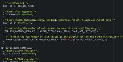

2023-08-31 5:50 AM
A quick look at SystemInit will show you it does change clock settings.
2023-08-31 6:13 AM
You are wrong. :)
