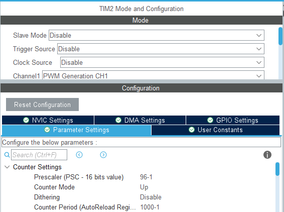

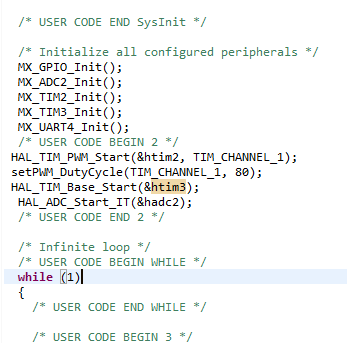

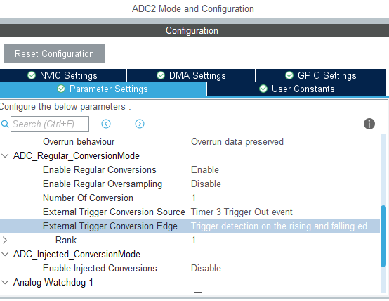

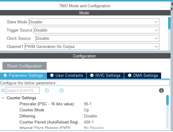

I AM USING NUCLEO-G491RE  MY SYSTEM CLOCK 96MHZ I HAVE USED ADC INTERNAL TRIGEERING TO ADC .I HAVE CONFIG AN TIMER3 FOR 400US THAT WILL TRIGGER ADC INTERNALLY  ON RISING EDGE  AND ADC IN INTRRUPT MODE . I HAVE USED TIMER2 FOR PWM GENERATION . BY THIS SHLOUD GET ADC VALUE ON RISIING EDGE ONLY BUT I AM GETTING VALUE ON RISING AND FALLING EDGE BOTH.CODE2.PNGCODE1.PNGTIMER3.PNGTIMER 2.PNGADC.PNG

You should be triggering only on rising edge for your ADC trigger if i understand well your question like below:
or else it will trigger on both rising and falling edge.
