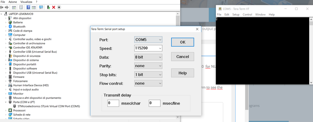

I'm simply want transmit on UART using code generated by CUBEMX 5.1.0 for NUCLEO F401RE in System Workbench (Version: Neon.3 Release (4.6.3)).
I've only added the following code in the main:
UartStatus is ALWAY HAL_OK after every transmission. I'm using Tera Term to see the serial data on COM5.
Thanks for help!

2019-05-04 11:24 AM
For testing, better use some printable characters rather than codes in control range.
Fore example
char buffer[] = "test";
HAL_UART_Transmit(&huart2, (void*)buffer, strlen(buffer), 1000);
-- pa

2019-05-04 12:00 PM
Thanks a lot Pavel! Now works good.
