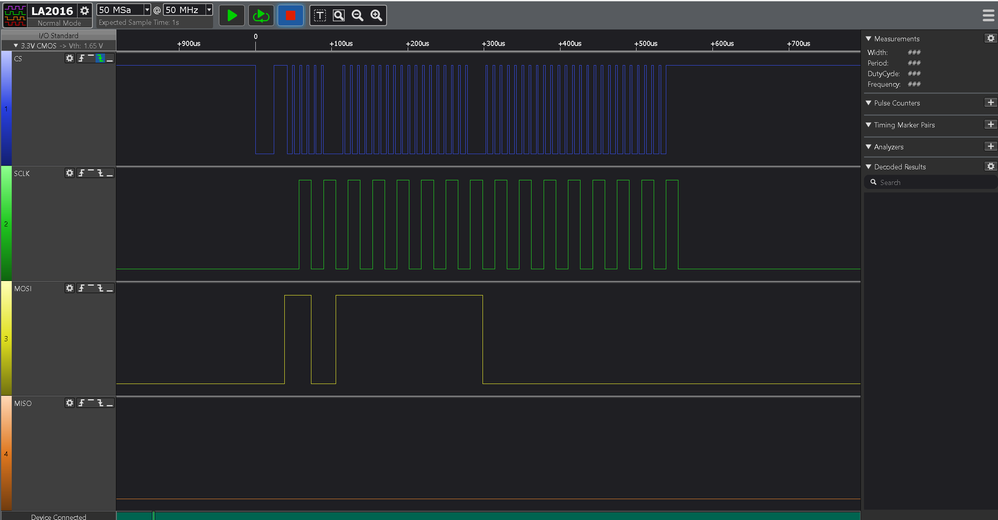

2023-03-29 8:39 AM
Can this issue also be causinig NSS to toggle and bounce in between TxRx? I have been using the HAL_TxRx in polling mode works fine, however, in IT mode, my NSS signal is bouncing many times in between TxRx.
Never had this issue before with other vendors. Like I said in polling works fine, in IT. I get this.
