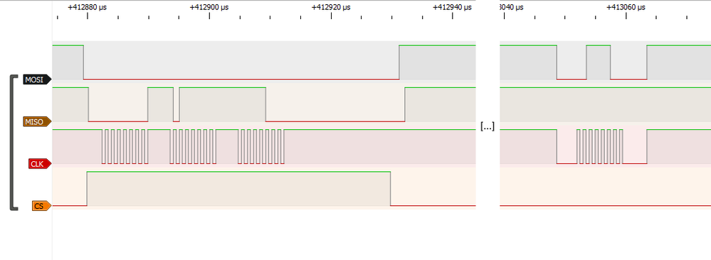

Well, almost SPI. Here is what happening: Master sets CS line high, and reads 3 byte from the Slave on MISO line. Then it sets CS line low, and sends one byte on MOSI line. CLK frequency is 1MHz, SPI Mode2.
I know it is not a proper SPI communication, so there is a transistor added that inverts the CS line. So the MCU doesn't see this in the image above, but the CS line inverted. It is a win-win, because it make the second short clock signal skipped, and that is exactly my intention.

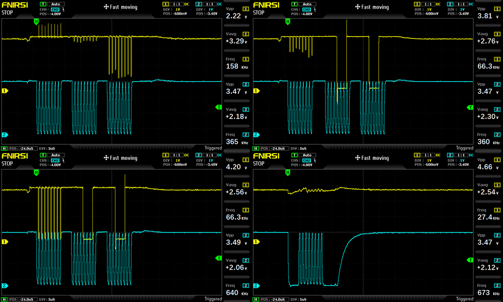

- It seems it cannot generate a proper 0xAA, it almost seems like noise spikes from clock
- It doesn't send the first byte. The second byte is the first, then it sends the third byte two times
- The second byte is one bit shifted to the left, the third byte is two bits shifted to the left
Images: AA AA AA is sent; AA AA F0, AA AA F0, AA AA F0 again, but I checked the other clock signal, when CS line is HIGH. (from the point of view of the Blackpill)

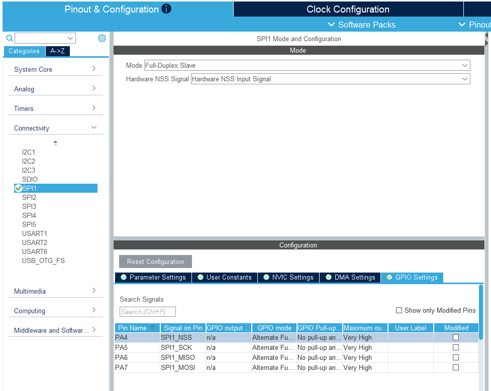

My config:

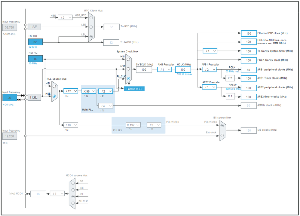

void SystemClock_Config(void)
__HAL_RCC_PWR_CLK_ENABLE();
__HAL_PWR_VOLTAGESCALING_CONFIG(PWR_REGULATOR_VOLTAGE_SCALE1);
RCC_OscInitStruct.PLL.PLLM = 12;
RCC_OscInitStruct.PLL.PLLN = 96;
RCC_OscInitStruct.PLL.PLLP = RCC_PLLP_DIV2;
RCC_OscInitStruct.PLL.PLLQ = 4;
Error_Handler();
RCC_ClkInitStruct.APB1CLKDivider = RCC_HCLK_DIV2;
RCC_ClkInitStruct.APB2CLKDivider = RCC_HCLK_DIV1;
if (HAL_RCC_ClockConfig(&RCC_ClkInitStruct, FLASH_LATENCY_3) != HAL_OK)
Error_Handler();

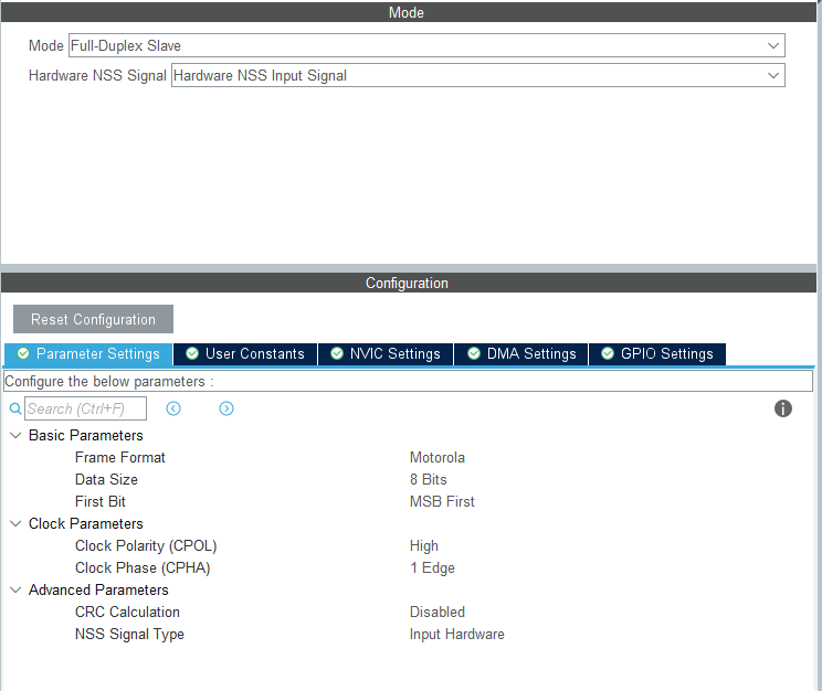

hspi1.Instance = SPI1;
hspi1.Init.Mode = SPI_MODE_SLAVE;
hspi1.Init.Direction = SPI_DIRECTION_2LINES;
hspi1.Init.DataSize = SPI_DATASIZE_8BIT;
hspi1.Init.CLKPolarity = SPI_POLARITY_HIGH;
hspi1.Init.CLKPhase = SPI_PHASE_1EDGE;
hspi1.Init.NSS = SPI_NSS_HARD_INPUT;
hspi1.Init.FirstBit = SPI_FIRSTBIT_MSB;
hspi1.Init.TIMode = SPI_TIMODE_DISABLE;
hspi1.Init.CRCCalculation = SPI_CRCCALCULATION_DISABLE;
hspi1.Init.CRCPolynomial = 10;
if (HAL_SPI_Init(&hspi1) != HAL_OK)
Error_Handler();

This isn't SPI. A slave doesn't respond when NSS is high and the MISO line is released (high impedance).
You'll have to set the slave to be always active (software NSS) and track the NSS line yourself.
Depending on the delay between and edge and the data, this may be difficult.
The second data the master sends has 9 negative-going pulses, not 8, which is going to complicate things even more. Seems like a bad implementation of a protocol.
2026-01-17 12:57 PM - edited 2026-01-17 1:18 PM
Sorry, my bad. I forgot to mention there is a transitor added to the PCB, that inverts the NSS line. I checked it with the scope, and the NSS line is proper: It goes LOW quickly, before the first clock signal from the 3 bytes package, it stays low, and then goes HIGH after it. So take the image from the logic analyzer I posted, and invert the NSS line in your head. That is what MCU actually gets.
Other than that, I don't care what Master sends, it doesn't matter. I only want to send my 3 bytes, that is all. So the CS/NSS line if perfect for my goals, after it is inverted.
