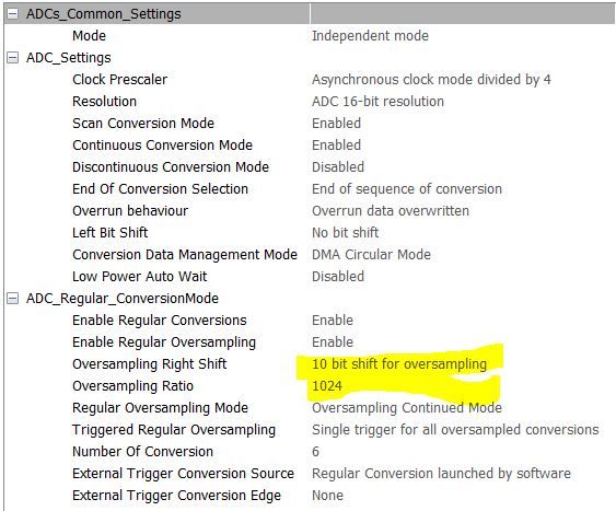

If have set the oversampling ratio for both ADCs to 1024 in CubeMx. The oversampler right bit shift is also set to 10 bits in CubeMX, which results in the oversampler value being set to ADC_RIGHTBITSHIFT_10 in the initialisation code. This fails the assertion. Below is an image showing my ADC setup.
I'm not manually initialise the ADCs but just running the code generated from CubeMX. So it could be a problem with the CubeMX code generation? Or CubeMX is allowing you to set invalid options?
I don't think setting the value to ADC_RIGHTBITSHIFT_8 as you suggested would work as my adc samples would end up 4 times too big. Oversampling ratio would also need to be adjusted to 256?
Perhaps I'm misunderstanding the role of the ADC right bit shift and oversampling ratio. Logically I think that if I accumulate 1024 samples, I need to then divide by 1024 to get the averaged ADC value.
1024 = 2^10
