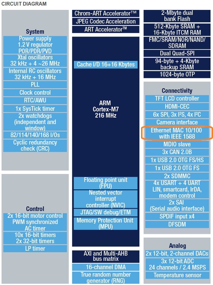

2018-10-03 8:27 AM
@STOne-32 The support for IEEE-1588 continually gets put in to diagrams and slide decks, but there seems to be a consistent lack of delivery for specific/worked examples of its use/application. Can we get someone within ST to take ownership of this issue?
2019-02-06 7:42 AM
The hardware for IEEE 1588 exists in SMT32Fxxx, so why can't ST document it and provide software examples? AN3411, and demonstration software mentioned in it, shows IEEE 1588 support, but they are no longer available. Why?
