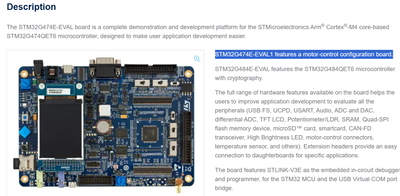

In fact, the STM32G474E-EVAL1 is recommended to be used for the motor control configuration board
This information is already mentioned below:

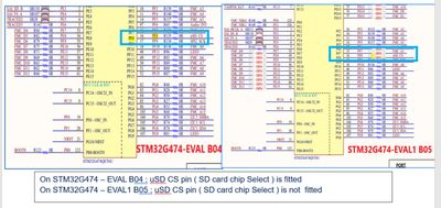

When comparing the obsolete STM32G474E-EVAL Board REV B-04 with the STM32G474E-EVAL1 board, we found that the uSD chip select pin does not fit. Therefore, the uSD chip select pin (PF8) must be fitted on the STM32G474E-EVAL1 Board.

2025-02-20 1:55 AM
Thank you so much for the reference, this board schematic is exactly what I was looking for (found on MXCube, the names of the files are a little bit confusing:
Both of them are B04 revisions and the part number in both of the files is the obsolete STM32G474E-EVAL.)
I'll update here if this helped to solve the problem.
Thank you

2025-03-09 4:45 AM
In addition to your previous answer, On the obsolete STM32G474E-EVAL Board REV B-04 uSD CS pin is fitted and there is resistor R135 in place, how do I know what kind of a resistor I need to choose in order to make the uSD chip select pin (PF8) fitted on the STM32G474E-EVAL1 board ?
Thank you
2025-03-09 10:34 AM - edited 2025-03-09 10:36 AM
>how do I know what kind of a resistor -
as you can see in the -eval circuit, its 0R = NULL ohm. So use solder or a small piece of wire...thats it.
