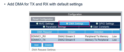

I can see the video but in this step I don't have the same configuration
And my evaluation card does not have a DMA tab? Maybe I'm missing a library ?
Yet the NVIC is activated. Probably the STM32F7 board is not the same as STM32L5 that why I don't have the DMA tab ?

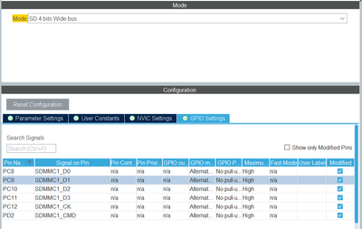

2024-06-24 3:19 AM

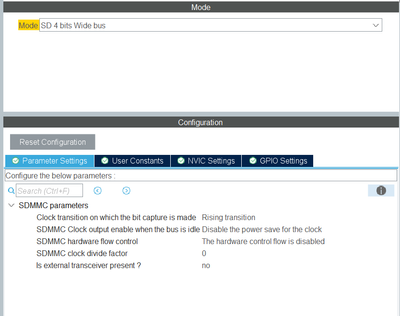

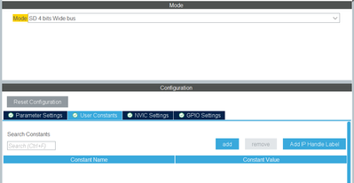

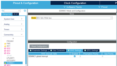

this config of SD card on STM32L552E-VE board can help you. If you use SD card for the application 'FatFs_uSD_Standalone' must enable SDMMC1 global interrupt.
I will be waiting for your feedback.
2024-06-24 4:48 AM - edited 2024-06-24 5:44 AM

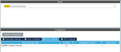

Hello M. Elhem,
Thank you for this information, after having verified I don't have the SD card but the µSD card, I think it's the same communication protocol for both ? Should I check the box 'NVIC Interrupt Table' or not ? After your previous picture we don't validate NVIC Interrupt Table.

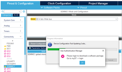

When I try to generate de code by STMCubeIDE I have this message :
Thanks
2024-06-24 5:52 AM
After login and download the update now i can have the code, now I can compare with the example code. Thank you.
