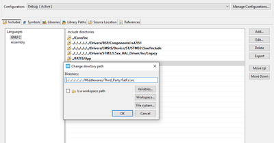

Someone sends me a project but when I open it on my PC I encounter the following error :
make: *** No rule to make target 'C:/Users/ghithab/STM32Cube/Repository/STM32Cube_FW_L5_V1.5.1/Middlewares/Third_Party/FatFs/src/option/ccsbcs.c', needed by 'Middlewares/FatFs/ccsbcs.o'. Stop. FatFs_uSD_Standalone C/C++ Problem

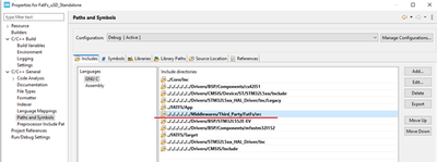

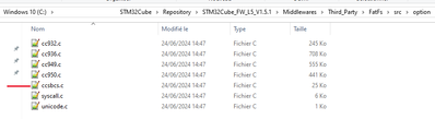

Do you know how to fix this problem ? However in my directory I have the file in question :
This probably comes from the configuration path but I only see points....
How i can see the full path instead of the....
Thank you for your helps
Regards

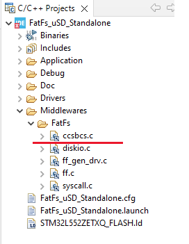

2024-11-20 6:39 AM
Yes I have this file in my Projet
So Where is the problem ? The Path configuration probably ?
