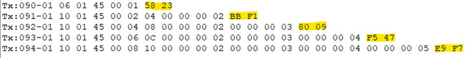

The following image is a Communication Log from Modbus Poll Software that shows the Modbus Frame being sent:

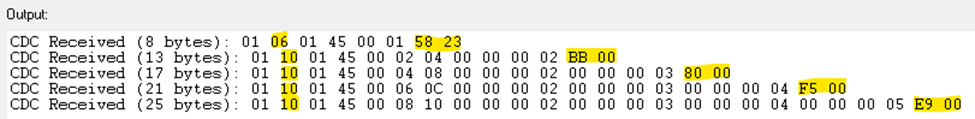

Notice the highlighted portions, which are the CRC Lo and CRC Hi bytes. I also confirm with a USB sniffer program that these exact frames are being sent to the slave. Also note that the first frame is function code 0x06 (Write Single Register), and the remaining frames are function code 0x10 (Write Multiple Registers).
Now, here is the incoming Buf in usbd_cdc_if.c, printed to the terminal right away:
Notice that for the first frame (Write Single Register), the CRC bytes at the end are intact and matches what we sent. Notice the remaining frames where I am having trouble with the last byte of the frame comes in as 00, which does not match what was sent by Modbus Poll.

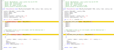

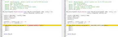

I wanted to share the change in stm32l4xx_ll_usb.c that ended up fixing the issue. In ST's GitHub, I found that this file was slightly different than mine was, so most likely we were using an outdated version.
Here were the changes that directly fixed the issue:
