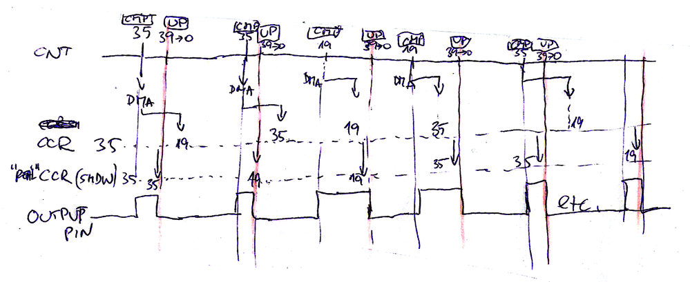

The problem is a combination of
I've made this back of the envelope drawing, but these things tend to get much clearer if *you* make this or similar drawing:
The remedy is simple, don't trigger DMA from CC, but from Update, i.e. don't set TIMx_DIER.CC1DE, but TIMx_DIER.UDE.

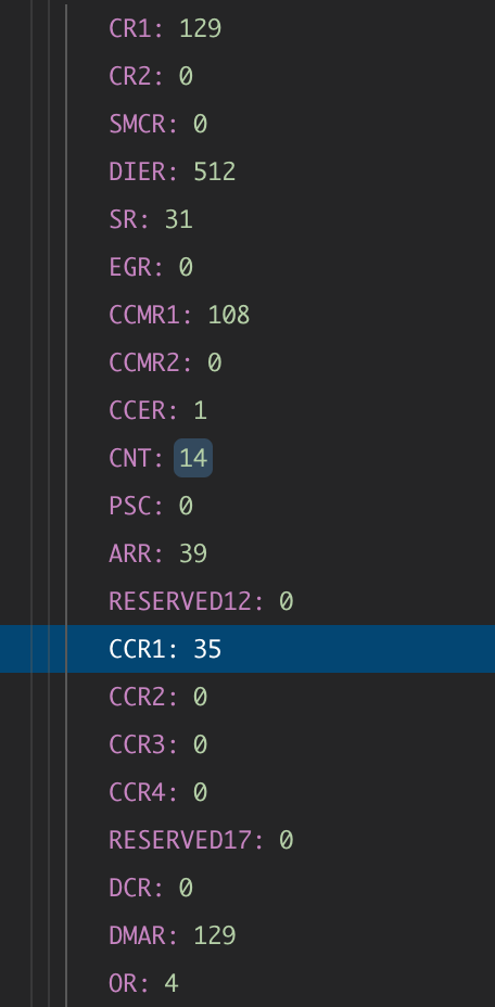

Some register values and a few more thoughts/questions:
Some of the TIM3 registers, using GDB:
I paused the application several times and can confirm the correct number is being set to CCR1. I cannot track the the value in real-time, since it's being transferred outside of CPU operations.

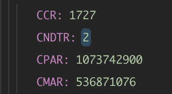

I'm not sure which DMA registers would help us here, but here are some of them:
I'm new to DMA, so I'd love to check my assumptions from what I've read about how this should work...
When setting DMA to memory -> peripheral (TIM). As I understand it, the peripheral (TIM3, in this case) will make a request to the DMA controller to receive the next value from memory. DMA will then send the value and, in this case, increment the memory location pointer for the next request.

2019-09-30 12:42 PM
Another thought. Looking at the timer registers, DIER has UDE (bit 8 - Update DMA request enable) set to 0. This could be affecting the request event, even though tthe CC1DE (bit 9 - Capture/Compare 1 DMA request enable) is enabled.

2019-09-30 1:13 PM
Wow, thank you for such a thorough response -- this is very helpful! I will give this a try tonight.
(I'm also starting to look at moving off of Cube)
2019-10-01 12:23 PM
It worked! Thanks again for the explanation.
