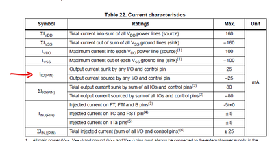

If you don't find this value in the DAC specific section or under "Absolute maximum ratings", you can safely assume it is not individually determined for DAC outs.
Perhaps ST staff can provide you more details.

no, I couldn't find the value specified anywhere. The value from your table is related to digital IO, I think. So, I think I've to clarify with ST staff as suggested by you.

In my opinion, the limit mentioned by Ozone generally applies to the DAC output. Furthermore, it is practically impossible to exceed this limit, because the DAC’s output buffer is not capable of supplying or sinking such high currents.
On the STM32G071, I shorted the zeroed DAC output against VCC (3.3V) and measured a current of approximately 1.7mA, and this had no effect on subsequent operation.
In my opinion, the minimum resistance value listed in the datasheet is not the limit beyond which damage occurs, but rather the minimum resistance at which it can be guaranteed that it will not affect the buffer’s function (it will not compromise accuracy).
The text in the table says "any IO and control pin".
If that includes DAC output pins as I would surmise is a question that only ST staff can answer, yes.
