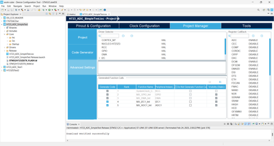

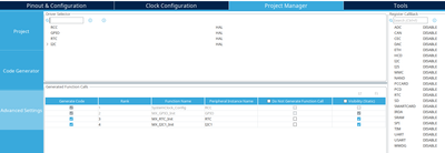

you have callback enabled in Cube?
2025-02-24 4:54 AM
Dear @AScha.3
thank you for your reply, yes it is activated.
I am attaching a respective screenshot.
Any suggestions would be really helpful. Thank you
