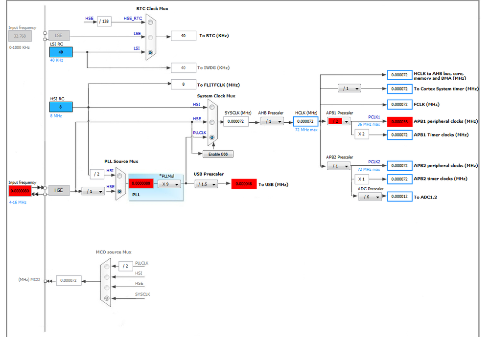

Hi, I'm using Cube v4.22 as Eclipse (version 4.5.2) plugin. I've encountered a problem with clock configuration - when I write a frequency in the Input Frequency field, Cube automatically divides it by million. This generally wouldn't be a big deal (putting value in Hz instead of MHz as indicated by the comment), but when I later touch any other setting or generate code, the value divides by another million again - producing wrong values in all the fields. I don't know if it actually affects the generated code, but surely it is annoying.
Screenshot of my Cube after I have written 8000000, enter and then started changing some ADC divider:
If I keep pressing enter while in Input Frequency window, it keeps dividing whatever is in there by one milion at a time.
All of above happens to LSE too.
Does anyone know where exactly the problem lies and if it is possible to get rid of it? I've looked through release notes of two newer versions of Cube and this problem was not mentioned as fixed.

STM32F103C8. The same happens when I try STM32F072V8. I think this isn't associated with any specific uC, it is a problem somewhere in Cube and/or Eclipse, as I don't even get to generating the code.
When I write 8 in the field and press enter or click anywhere outside the box, it automatically divides by 1000000 and leaves same screen as I attached.
If I enter 8 with as many zeroes as needed, I get to generate code with correct value visible on screen and the code works correctly, I'm aiming only the necessity of writing a number with many zeroes to get the correct, lone 8 in the field.2017-11-13 9:24 AM

Hi, I've manually downloaded the latest version of Cube (4.23). LSE was bugged as soon as chosen, HSE was correctly set at 8MHz until I tried to write the value manually. I didn't update Eclipse.
I'm attaching the .ioc file.BTW. If only 32768Hz quartz is accepted as LSE, maybe the option to write arbitrary values in the Input Frequency for LSE is not needed?

Over a year passed and this annoying bug still exists. I've downloaded newest SW4STM32 with newest Cube (and checked for updates) and again I can see this:
I've tried manually changing the value in .ioc file to 32768, 32.768 - whatever, it still divides it and then constantly bothers me with message that my clock system is #$%^ up.
Now with old cube I was able to work around the problem by putting 32768000, which then automatically divided into correct value. Currently I am unable to write into LSE Input Frequency (so this definitely is not my fault, that there is wrong value in that field!)
I tried to overcome it by editing the .ioc file, but whatever I write (32768, 32768000, 32.768) Cube still divides this value by 1000000 whenever I open Clock Configuration panel.
I even tried building a project on H743ZI Nucleo board using the option of having everything predefined to the board. And guess what - from the start the Clock Configuration was messed up by LSE input frequency field.
BTW. This "Save Project" popup should definitely appear less frequently, it's annoying. And user can't change it at all. User preferences box is empty.
So now, that the problem is definitely not caused by me using outdated software, why is this out-of-nowhere LSE input division still here?!
@atomassini I've already been using this workaround, but now I can't even write into LSE input frequency field.
