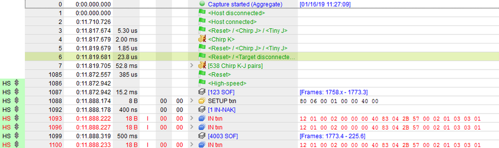

It is seen by the host and enumeration is started, but fails. My Beagle SUB 480 protocol analyzer shows a response, but I think it is at the wrong time.

It may be a little hard to read, but I think my issues is the first Setup packet is naked. Anyone?

Turns out I did everything right in FW. There was a pin conflict in HW. Thanks for your help.
