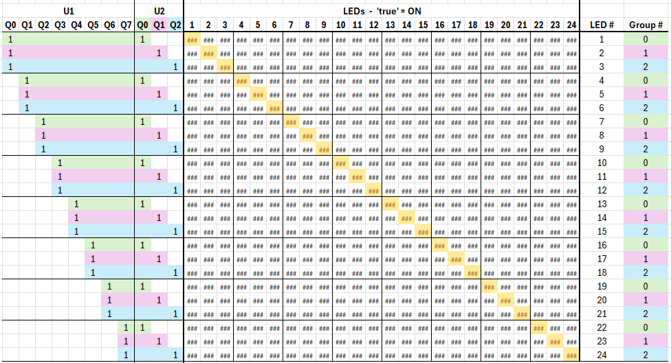

2024-11-20 4:38 AM - edited 2026-02-14 7:20 AM
Friends, which algorithm do you use to control the LEDs in this structure? I need your ideas. I have prepared a table of the LEDs' turn on order.

Thank you. I control 24 LEDs by scanning with 250us using the codes I gave.
But as I said at the beginning, I opened this topic because I did not like the code I wrote.

Never mind, focus on the other topics. I don't like you questioning me. You don't have to answer every topic. Those who want to help me and guide me are already showing themselves. You are constantly being rude. I don't really get along with you. The question is very clear and simple. "How do you control these LEDs?" Sometimes I may want to light up just 1 LED, sometimes 10 LEDs. That's the question and it's simple. But never mind. You can ask 100 questions now.

These are the sensor inputs coming to my input port.
I turn on the LED that belongs to the sensor from which data is coming.
Data is coming from 10 different sensors at the same time and I need to turn on 10 LEDs at the same time.
When I send it one after the other (250us), the LEDs I want turn on.
But as I said, I opened the title to learn how to control it differently.

HC4094( required_leds );As @unsigned_char_array pointed out earlier, your display consists of 8 groups of 3 LEDs.
So have the HC4094() function inspect the bitmap of which LEDs are required to be on, and then write to each group in turn.
That way you can write to 8 LEDs at once - instead of just one at a time.
Then you don't need to scan so fast - so your LEDs can be brighter.

2024-11-22 7:08 AM
@Andrew Neil wrote:As @unsigned_char_array pointed out earlier, your display consists of 8 groups of 3 LEDs.
I mean 3 groups of 8 LEDs:
2024-11-22 7:21 AM
So each bit in required_leds represents one LED:
|<---- unused bits ---->|24 23 22 21 20 19 18 17 16 15 14 13 12 11 10 9 8 7 6 5 4 3 2 1
required_leds | | | | | | | | | | | | | | | | | | | | | | | | | | | | | | | | |
Group 0 LEDs: 22 19 16 13 10 7 4 1
Group 1 LEDs: 23 20 17 14 11 8 5 2
Group 2 LEDs: 24 21 16 15 12 9 6 3
