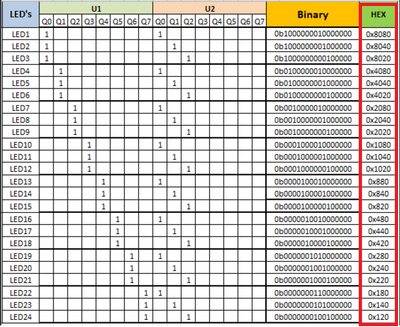

Friends, which algorithm do you use to control the LEDs in this structure? I need your ideas. I have prepared a table of the LEDs' turn on order.

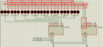

2024-11-20 4:50 AM
Have you examined the electronic circuit?
for example, what should be the algorithm to turn on led1 led2 led3 and led4?
Because when led1 led2 led3 is active, the (2nd) 74hc4094 integrated circuit on the right has to give cathode information to all leds.
If you turn on led4 while led1 led2 led3 is on, how will you ensure that led5 and led6 remain off?

@XooM wrote:what should be the algorithm to turn on led1 led2 led3 and led4?
That's what the table you posted tells you - it tells you what values to write to get each LED illuminated.

You need to ensure that for each clock. And each data needs to correspond to that anode and cathode state at each step with a lookup table:
const uint16_t tab[] = {0x8080, 0x8040, ....};
This is based on the table shared by you:
I don't want to enter in the details value and check the content of the table. I've already provided the concept.

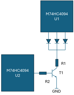

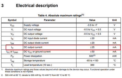

Need to use transistors for the 74hc4094 on the right. I don't think the pin could sustain a such current consumed by all these LEDs (sink current).
M74HC4094 datasheet:
A proposed structure to prevent to exceed sink current:
For each LED branch you need a transistor. In your case 3 transistors.

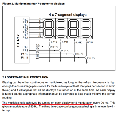

Normally you need to mention the timing from the beginning.
The timing is the same as for the 7-segment display control, and you need for each step to let the LED to lit for 5ms duration. So 250us is a very short duration to let the human eye to catch the event.
Look also at the HW structure. (source: https://www.st.com/resource/en/application_note/an1781-str71x-gpio-driving-four-7segment-display-stmicroelectronics.pdf)

Yes, that's right, I'm using 3 transistors in my circuit as you said. I didn't want to show it here for my algorithm. I asked for some help with the coding part. I'll upload my own codes when I get home.
