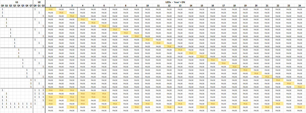

2024-11-20 4:38 AM - edited 2026-02-14 7:20 AM
Friends, which algorithm do you use to control the LEDs in this structure? I need your ideas. I have prepared a table of the LEDs' turn on order.

2024-11-20 9:54 AM - edited 2024-11-20 10:35 AM
You image in question make more problem as info. Missed transistors is then on right side and left 8bit is connected to LED direct. Then your code need
array uint16_t LEDs[3] = { 0x0080, 0x0040, 0x0020 };
for set leds 0-7 manage
LEDs[0] |= (8bitled) <<8 ; you can manage this all 8 led
for 8-15
LEDs[1] |=(8bitled) <<8 ;
then your led manager timer every 5ms show one of this

2024-11-20 10:13 AM - edited 2024-11-20 10:15 AM
No your code isnt ok , because led light if more as one input active only some us . if Only one input is active led light relative ok only one data is send to one led and repeat in time input is selected.
But i mean your real situation not guarantie only one input selected ?
TRY in timer only my code and set values in main based for all 24 leds.
2024-11-20 10:27 AM - edited 2024-11-20 10:31 AM
Too your code send into 595 LSB first, but normal logic is MSB first. Then maybe try change
if(data & (1<<(15-i)))and swap bytes in array
uint16_t LEDs[3] = { 0x0100, 0x0200, 0x0400 };
for set leds then
LEDs[0]|=8leds;...
