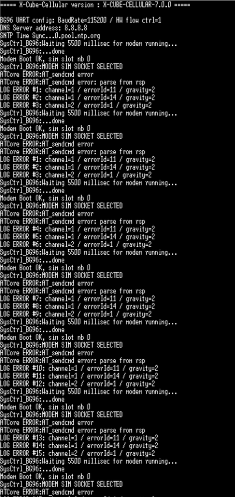

What we see here is the folowing log:
===== X-Cube-Cellular version : X-CUBE-CELLULAR-7.0.0 =====
BG96 UART config: BaudRate=115200 / HW flow ctrl=1
DNS Server address: 8.8.8.8
SNTP Time Sync...0.pool.ntp.org
SysCtrl_BG96:Waiting 5500 millisec for modem running...
SysCtrl_BG96:...done
Modem Boot OK, sim slot nb 0
SysCtrl_BG96:MODEM SIM SOCKET SELECTED
ATCore ERROR:AT_sendcmd error
ATCore ERROR:AT_sendcmd error: parse from rsp
LOG ERROR #1: channel=1 / errorId=11 / gravity=2
LOG ERROR #2: channel=1 / errorId=14 / gravity=2
LOG ERROR #3: channel=2 / errorId=1 / gravity=2
LOG ERROR #4: channel=1 / errorId=11 / gravity=2
LOG ERROR #5: channel=1 / errorId=14 / gravity=2
LOG ERROR #6: channel=2 / errorId=1 / gravity=2
If we enter the "cst state" comamnd into TeraTerm, we see, that APN, username and pasword have been set correctly.
What could cause this behaviour and these error messages? What are we doing wrong?

because there is no answer to my problem yet, i will aks a more specific question:
What is the meaning of the error messages that I see on my terminal?
And what causes them?
I mean these errors:
LOG ERROR #10: channel=1 / errorId=11 / gravity=2
LOG ERROR #11: channel=1 / errorId=14 / gravity=2
LOG ERROR #12: channel=2 / errorId=1 / gravity=2
best regards
Michael
