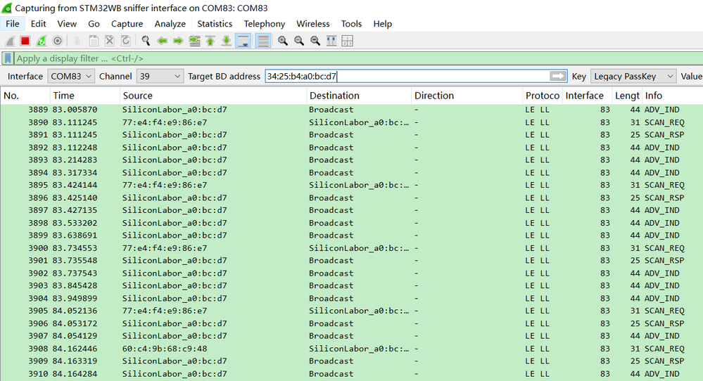

When I followed the link https://wiki.st.com/stm32mcu/wiki/Connectivity:STM32_Sniffer_for_BLE_Setup_guide,I successfully make Neclueo-WB55 be sniffer device while STM32WB sniffer displayed in the wireshark startup page,meanswhile I really capture the BLE advertise packets like this screenshot 1,

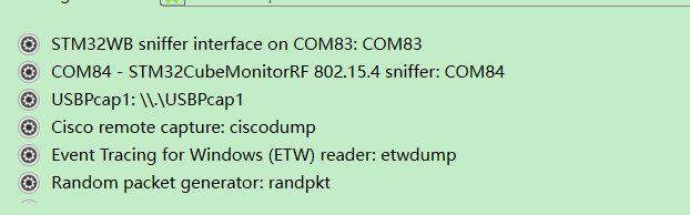

But come problems,it only capture advertise packet as title said,connection packet like GAP parameters update or CONN_REQ all cannot be captured,how I should do to solve this problem like screenshot 2,

as it is seen in your second screenshot, you were capturing packets from BLE Channel 39.
The reason why you see only advertising packets is, as it is said in Bluetooth Low Energy specification, Volume 6, Part B, that channels 37, 38 and 39 are used only for advertising and any other communication should be handled in remaining "general-purpose" channels.
So if you want to listen to a specific application, you have to tune your sniffer to according channel.
