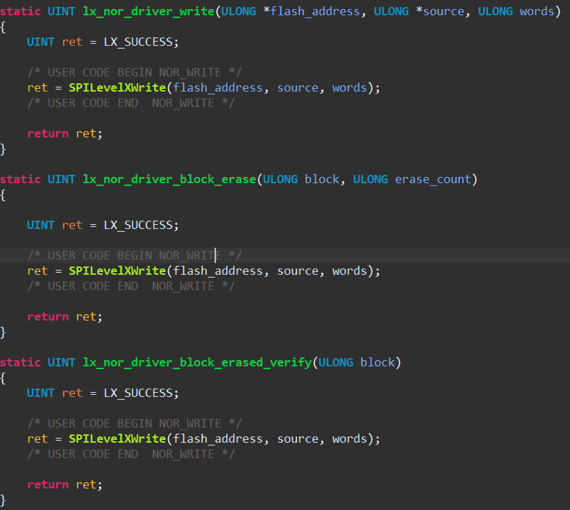

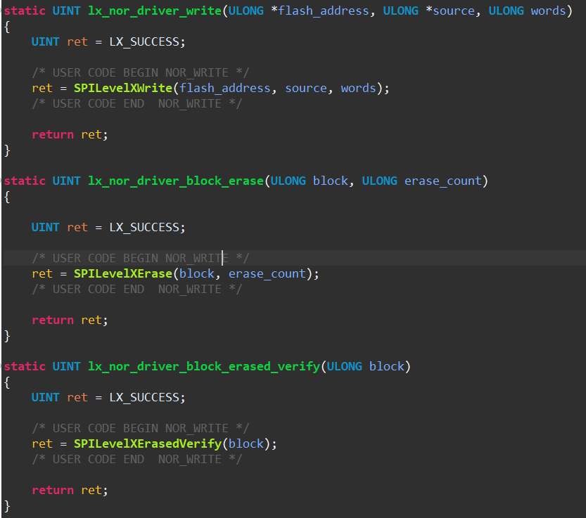

There is a bug in STCubeMX regarding LevelX. After changing the settings in the Code Configurator (even those not related to system settings, only e.g. UART) the "lx_stm32_nor_custom_driver.c" file is being damaged. Namely, the content of our custom code placed in the lx_nor_driver_write function is inserted into the lx_nor_driver_block_erase and lx_nor_driver_block_erased_verify function. See the before and after screen grabs - these are only single lines placed between /* USER CODE */ comments. We are currently working with v1.10.1, however, after upgrading to v1.11.0 the issue persists. We use a processor from the H7 family, namely ST32H723, FileX, LevelX with NOR driver (custom NOR driver). This error limits the use of the Code Configurator by our team. Can we expect the bug to be fixed soon?

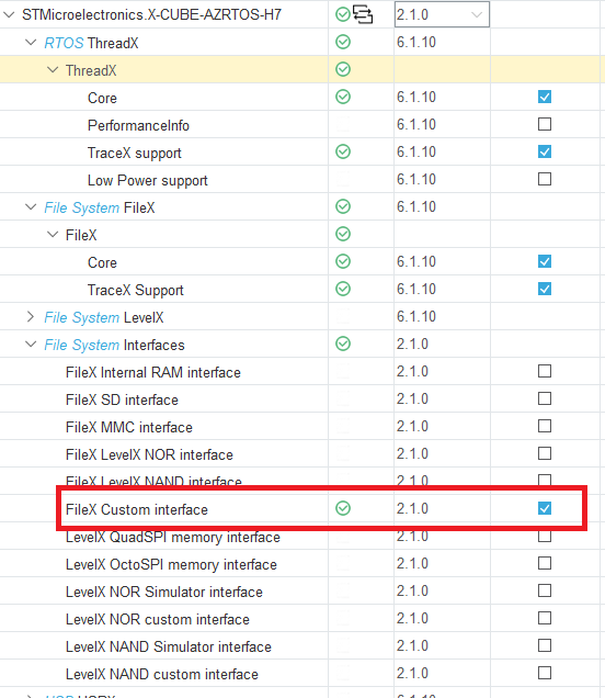

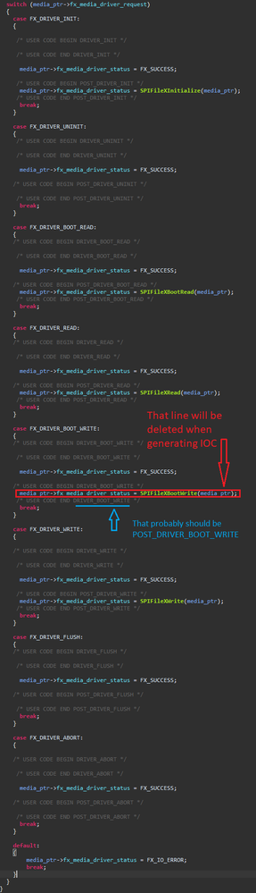

I would like to add that I found another bug similar in nature, but this time in FileX Custom Interface. This is a custom driver for FIleX (without LevelX), located in FileX\Target\fx_stm32_custom_driver.c. The line in the switch-case statement "FX_DRIVER_BOOT_WRITE" is deleted after re-generating the IOC. In my opinion, the "POST_DRIVER_BOOT_WRITE" should be in indicated place, instead of "DRIVER_BOOT_WRITE". I think that the empty line above is being inserted at the place shown.
I would like to ask the development team to fix this bug as well. How are things going with the previous report?
