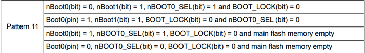

You can use any of the Pattern11 propositions to go to boot mode:
So, you can use the first one that does not need to use the boot0 pin.
PS: STM32G070x devices do not have BOOT_LOCK (bit), consider that when using Pattern 11.

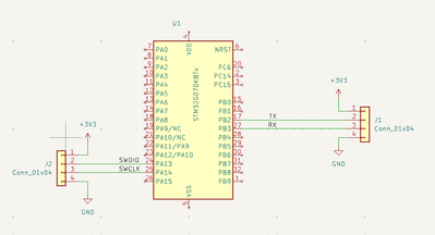

Hey guys for the final verdict that I understood everything, I selected the nBoot0(bit)=0,nBoot1(bit)=1,nBoot0_SEL(bit)= 1 and BOOT_LOCK(bit)=0 from the cube programmer and then I can use both the programming option UART and SWD without worrying about the Boot0 pin.
I have also attached the schematic just for these programming interfaces, also suggest if I have to add anything related to programming.
2024-08-13 9:40 AM
Yes
Best Regards.
STTwo-32
2024-08-13 9:44 AM
Little missunderstand, you cant run your code with power on, but yes program it work allways.
