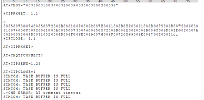

Thanks, it may be true and I don't know why I didn't think of that. Here is the example of error. In fact now I see that if that message had been sent the modem would not have been blocked because it's all data it need to response. Below there is CME ERROR from modem which tell that message was correctly handled.

Data are transmitted also in main loop if there is defined delay in sending command but the code is written to send simultaneously only one message, wait for response and then send next. Also every RX and TX message is forwarded to debug uart which print screen is visible above.
Could the cause be that RX dma has higher priority than TX and as visible on print screen in time of sending data in SMS there is another incoming message +IPCLOSE which break transmission?
