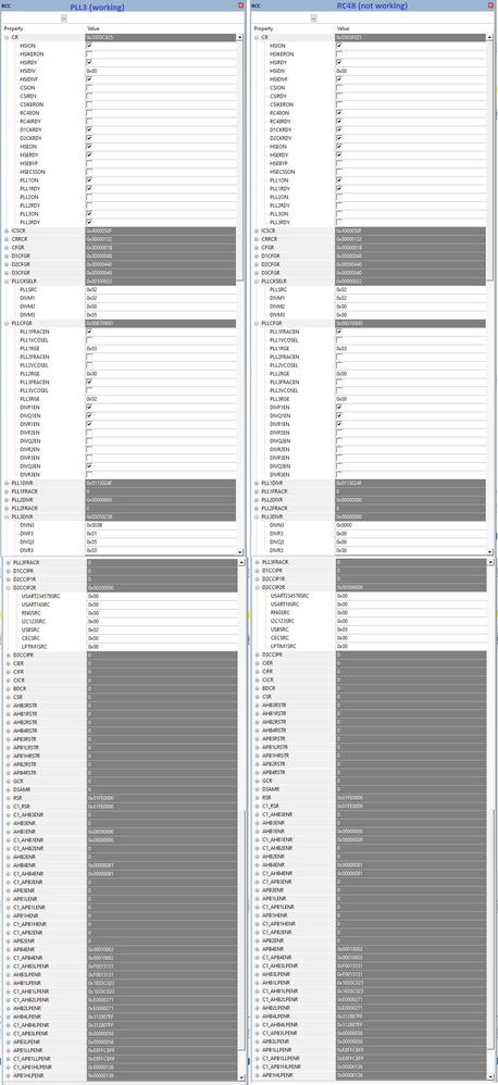

HSI48 should be calibrated to some external source with the CRS peipheral, either to LSE or a SOF signal coming from another host. CRS is not running (APB1HENR = 0), LSE is not running (BDCR = 0), and there is no incoming SOF because you are the host.
This should not prevent an USB core reset though, but I am not exactly sure what an unconfigured CRS would do to HSI48. Anyway, not a healthy configuration.

Can you post the contents of all RCC registers for the working and non-working cases?
2020-04-26 10:51 AM
sure, here is a picture, mapping all changed RCC registers just before the soft reset should occur.
On the left the working PLL3 configuration and on the right the non working RC48 configuration.
