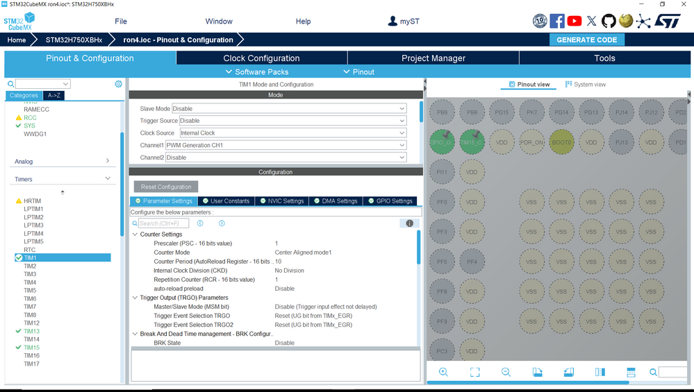

STM32H750 Discovery Kit board, Timer 1, Ch1 (PA8 output)
I used direct access to timer registers as a HAL library and the result was similar.
I can receive 10 MHz with direct access to register and TIM1->PSC = 10;
But when I set TIM1->PSC = 1 I don’t receive any signal from Timer1 with the next script

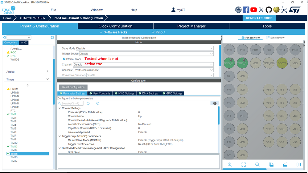

and the same problem for other Timers
as example
HAL_TIM_PWM_Start(&htim15, TIM_CHANNEL_2)

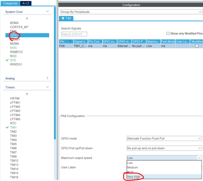

You can change it in the GPIO tab on the left.
2024-08-27 5:35 AM
Make sure pins are set to very high frequency. I bet the signal is there but with slow edges. What oscilloscope are you using?

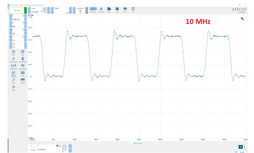

Hello, thank you, I use PicoScope6404D (500 Mhz)
what do you mean about - "Make sure pins are set to very high frequency. " I use a timer and PWM and made only "Fast Mode" - Enable

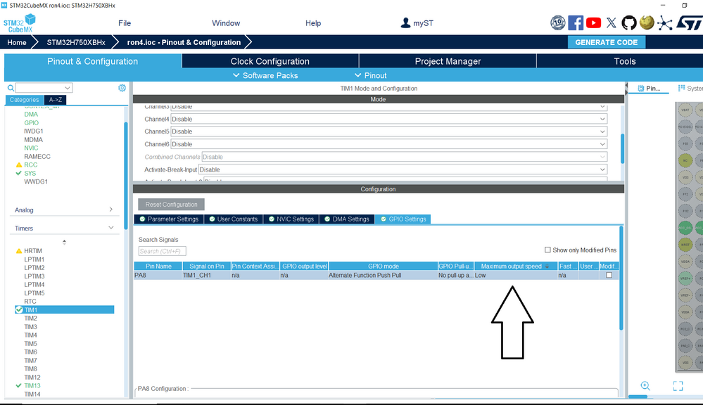

2024-08-27 6:03 AM - edited 2024-08-27 6:03 AM
I dont have access to GPIO via Cube
2024-08-27 6:11 AM
2024-08-27 6:17 AM - edited 2024-08-27 6:18 AM
ohhhh, it is works now, thank you so much, my god how did I miss this!!
