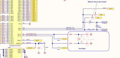

>>so i think my board have an external crystal
You can add one as an option
Usually you can get an 8 MHz from the ST-LINK/V2-1, so HSE in BYPASS mode

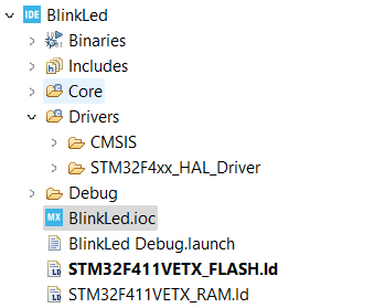

You have two projects in the zip file you attached:
And the Drivers folder has "BSP" folder:
Not clear how that was generated by CubeIDE? did you copy and did some changes in the folder structure?

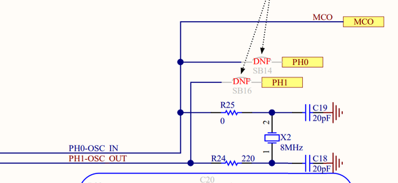

I ran the same code as you on a STM32F407VG-DISC board it it works, even with MX_USB_HOST_Process(); in place.
The LED's are on the same PD12-PD15 pins. Being it's the same family, it uses the same FW. I'm currently using STM32Cube FW_F4 V1.28.2
You've mentioned that the LED only blinks in HSI. Go back to using HSE and use an oscilloscope to verify if you see clocking on PH0 pin of the STM32.
Also make sure R25 and R24 resistors are in place.
