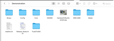

So I have load the STm32f429I-Discovery board project in the cubeIDE. I have checked all the pinouts are the same as in the provided documentation. So I dont have purple display any more, but lines. Still no text.
also I have downloaded folders with files. I have a "BSP" folder and "Demonstration". My best result for now is that I can see those folders in my project. Please advise how files should be added to a project? Via "Import" ? I am having hard times to figure out how to put all those files together and print something on a display.

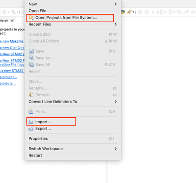

Hello. I have a question regarding CubeIDE projects. While loading a STM32 project and choosing my Discovery board from the board menu - I want the program to load it with all pins assigned. And sometimes it work, but sometimes with the same sequence it is loading a completely clean project with no pins assigned. (typically there is a prompt asking to initialise peripherals). Is this a know bug? Thank you.

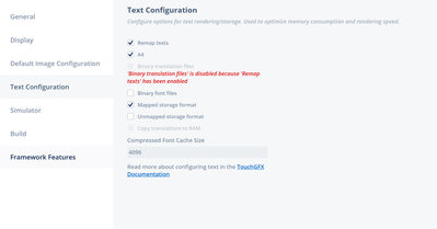

I have results now. I can display images now. With simple Text there was a problem. TouchGFX wouldnt display text in Run Simulator for some reason. Helped to uncheck box "Binary Font Files" any advise why this checkbox would not show text while run Simulator? Thank you
