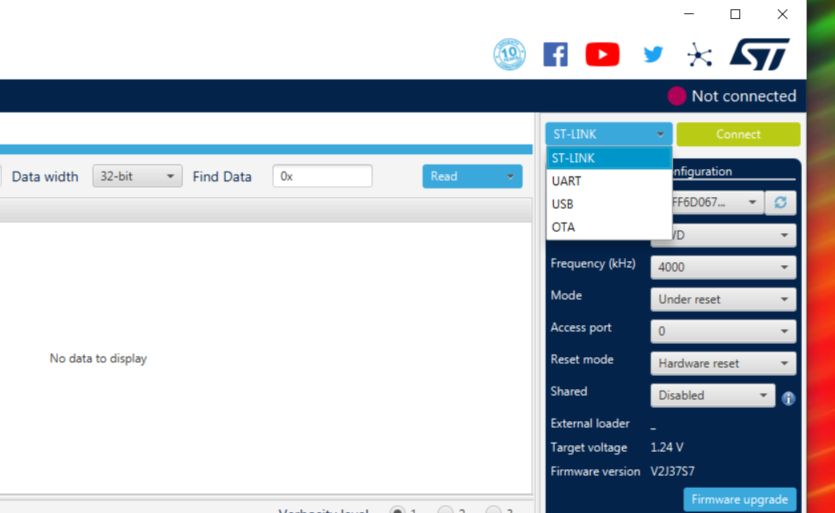

The stm32 builtin bootloader (the one that comes with every chip and cannot be erased)
Has a lot of options for the source of the data including USB ,UART, I2C, SPI, CANBUS.....
So you could Programm your chip with CUBEprogrammer just using your PC's USB(host) port and the builtin ST bootloader USB (device)
For the SD card option you would need to make your own bootloader i believe.
