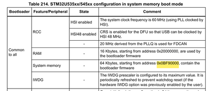

Jump to the address specified by the vector table at 0x0BF90000.

The relevant information in AN2606 is provided in Table 214, “STM32U535xx/545xx configuration in System Memory boot mode,” which indicates that the System Memory bootloader base address for the STM32U535 is 0x0BF90000. This same address applies to the entire STM32U5 family.

@Moktar Something is off with this reply. The addresses in Table 3 do not match what is done here:
https://community.st.com/t5/stm32-mcus/how-to-jump-to-system-bootloader-from-application-code-on-stm32/ta-p/49424
Literally none of them match. The OP asked for an address to jump to. Which is correct?
Right is 0x0BF90000, but this isnt jump address! Here start VTOR table then first u32 is MSP and second stored value on 0x0BF90004 is address to jump...
Fair enough. I guess my point is that 0x0BF90000/0x0BF90004 should appear in the code, not 0x0BF99EFE. I corrected my reply for this distinction.
Hello, @MM..1 , @TDK
I was misled by Table 3 of the AN2606. The address I previously provided corresponds to the bootloader ID, not the actual jump address.
I stand corrected regarding the recommended procedure for transferring execution to the System Memory bootloader.
The correct boot loader address start is 0x0BF90000.
I have corrected my previous reply.
Thank you for pointing out the issue.
Best regards
