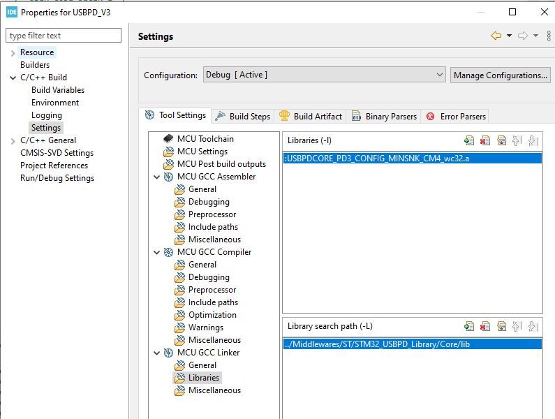

c:\st\stm32cubeide_1.6.0\stm32cubeide\plugins\com.st.stm32cube.ide.mcu.externaltools.gnu-tools-for-stm32.9-2020-q2-update.win32_1.5.0.202011040924\tools\arm-none-eabi\bin\ld.exe: cannot find -l:USBPDCORE_PD3_FULL_CM4_wc32.a
Even when i changed the configuration back to Min Sink there was the same error for Min Sink...
So i think anything ist wrong there already at the beginning.
I also tried to build a project in CubeMX and open it in CubeIDE because the folder structure is different then. But i had the same problem.
I dont know what to do because first after compiling there is no error and after changing to other configuration and back, what should be the same like before, there are errors...

For your compilation issue when you have changed the library, could you please check that the settings in CubeIDE is still valid like this:
