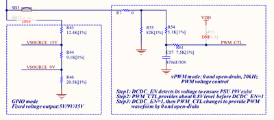

I am able to define a PDO that offers 20V. I am able to then with my SNK to request the 20V PDO. However, there is no way to synchronize with the logic running in the MCU to switch to the 20V source. Would be cool if the MCU sensed the voltage and only sent out PSRDY once it sees 20V. But I guess coding that logic is left up to me as this is only a demo board.
I am using this as part of my test bench. I am using this to test my own hardware. I want to be able to send voltages and do other various things. This is working well with STM32CubeMonitor-UCPD. My plan now is when I push the button for my SNK to request 20V, I will at that moment push a button on another interface that will switch my PSU to 20V. I was hoping that this board would have at least 2 power paths to allow a power switch, but it does not. So I believe my only choice is to come up with a way to do the switch manually as indicated.

I don't support power management cases about 5V. I can give you hints on where to dive deeper but this is out of my scope. You can refer to the schematics provided

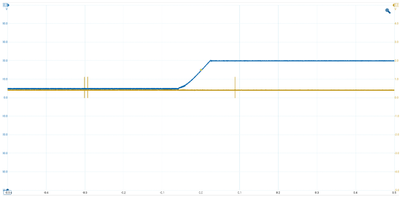

At the moment the source for the src1m1 demo does not care about what voltage is present of if any voltage at all. At power up it starts advertising it's PDOs even without any voltage. If you request a 20V PDO it will send accept immediately followed by PS_RDY without any check on the actual voltage being provided. So what I want to do is actually for it to be more compliant.
When you say "if the requested power can be met" the existing software only checks the source PDOs. Which is fine for ACCEPT. But for PS_RDY it should check the actual voltage. At least it should delay sending PSRDY for as long as it can if it does not yet see the voltage. I get that if the voltage never comes thats a kind of software design issue you might not want to tackle in this demo.
2025-07-22 1:26 PM - edited 2025-07-22 1:29 PM
I have edited src1m1_usbpd_pwr.c and added in the osDelay call. It gives me a delay.
