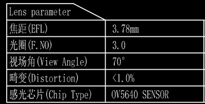

What is the lens used on the B-CAMS-OMV kit? Or, what is the field of view? or, what is the focal length?
2025-07-22 7:54 PM
The camera module part number is HDF5640-AF-V2.0 on B-CAMS-OMV. Pls. find lens parameter below.
2025-07-22 7:54 PM
2025-07-23 6:01 AM
Many thanks! That's what I'm looking for!
