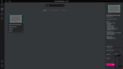

You can change the TBS revision here:
However, I am unsure which version you need.

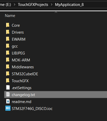

You can look at the changelog to see what has changed and which TBS will be compatible with your board:
