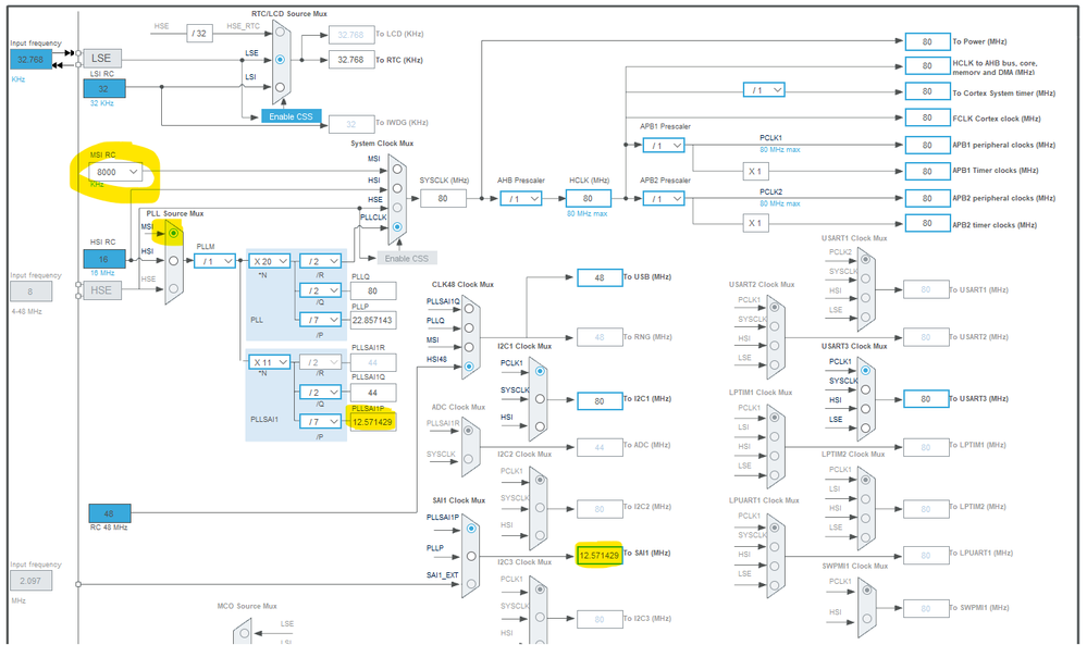

The clock configuration is below...

2025-11-27 8:15 AM
Thanks, I set MSI to 8MHz and was able to achieve 12.571Mhz for the I2S clock (just as I was trying to do with the 8MHz external crystal!)....

2025-11-27 9:34 AM - edited 2025-11-27 9:37 AM
Good point I should be trying to fit a 12.888mhz crystal for 48khz audio.
but my system clock is currently running at 80mhz (now using MSI)
If I fit a 12.888MHz crystal then what would the system clock run at ?

@freeflyer wrote:If I fit a 12.888MHz crystal then what would the system clock run at ?
That will depend on what you do with the PLL and the various dividers ...
2025-11-28 3:31 AM
12.288 MHz
Attention to detail is very important for electronics development!
Check all other peripherals and interfaces if they need a specific clock which might not work with 12.288 MHz *x/y.
For PLL checking CubeMx is really great.
