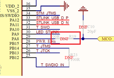

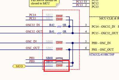

Except for STLINK-V3, you configure the STLINK to generate the MCO signal from the crystal using STM32CubeProgrammer STLINK updater tool. Which is not the case for NUCLEO-L433.
@freeflyer Why you need to add a crystal while you can retrieve the precise clock (8MHz) from ST-LINK-V2?
But for that you need to:
1- Solder: SB64:
2- Solder R19: you can put 0 ohm
3- Configure the HSE in Bypass mode in CubeMx.
