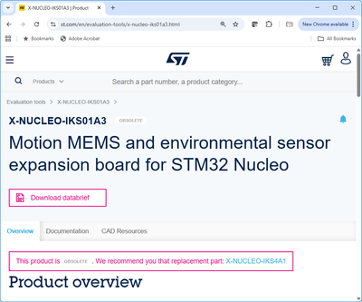

Unfortunately, this board is shown as Obsolete:
So a lot of the support has been withdrawn.
But the User Manual & schematics are still there, and most of the individual sensors are still 'Active':
