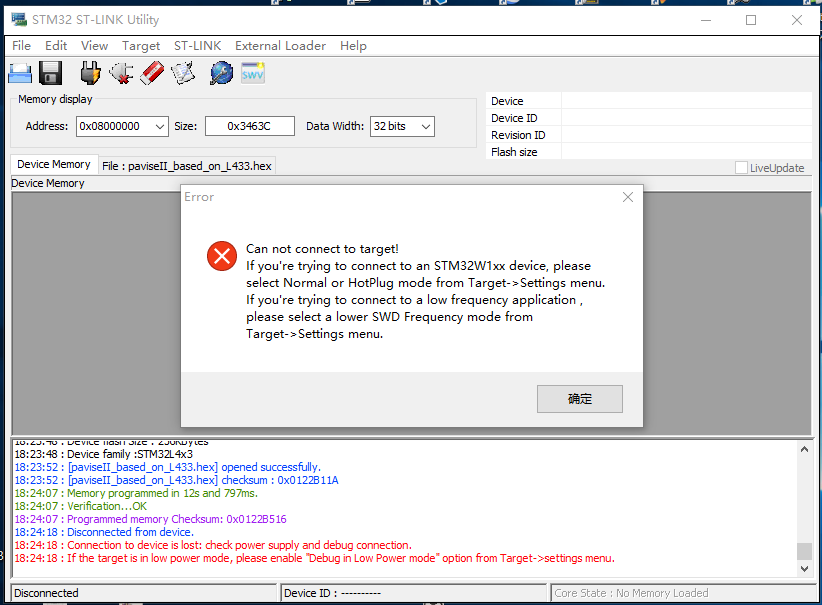

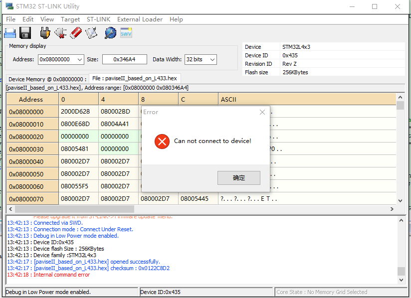

Your code, when executed, disables or changes pin settings on pins used by the debugger, or powers down the chip or interfaces?
