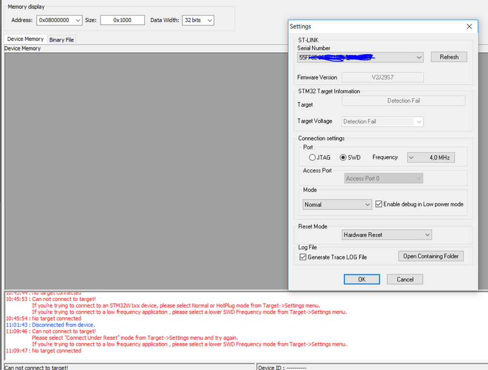

I'm trying to use the CN12 SWD connector and the ST-Link/V2 programmer to flash my Disco-L072CZ-BLRWAN1 board.Next, I want to program my own board with a Murata Cmwx1zzabz module but first I want to know how to do it properly with the ST-Link/V2 and the Disco board.
I removed the 2 connectors from the dev-board (CN8) in order to use the ST-Link connector and not the ST-Link from the USB. Regarding the (UM1075) user manual ST-Link in-circuit programmer, I connected the signals following :
MCU VDD => VDD_Target
GND => GND
SWDIO => SWDIO
SDWCLK => SWCLK
NRST => NRST
TRACESWO => SWO
My ST-Link firmware is up to date. I'm trying to use the ST-Link utility first but it seems the target is not recognize (connection between ST-Link and the MCU).
Does the MCU is powered by the programmer when the programmer is flashing it or do I have to power the board using the 3V3 and GND connectors?
Best regards.
2018-11-22 3:32 AM
You'd want to disconnect the on board ST-LINK, and then use the target side SWDIO and SWCLK pins, not the output header.
This is a topic area that has been covered multiple times. Review the board schematic.
2018-11-22 3:32 AM
2018-11-23 3:52 AM
You're right, my aim was to have the lowest power consumption so I removed the SB37 (used for NRST) then when I tried to use the STM32 Utility, it didn't work. Now I manage to connect it properly by using the reset button just before the connection.
Thank you for your time!
