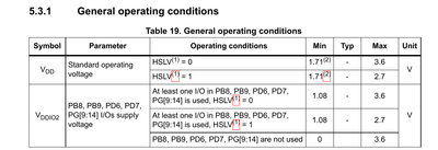

seems some pins can work at this voltage, but not the whole cpu: on H523..H562+563

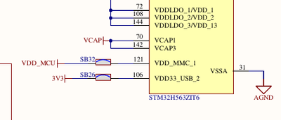

2025-03-15 8:43 AM - edited 2025-03-15 8:49 AM
yes, i have the nucleo-H563 , there you can separate the vddio2 pin 121 and then supply it ...yourself: at 1.2V ...

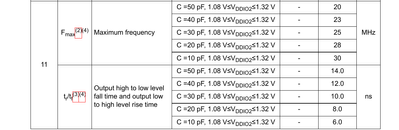

...but be aware: pins at 1.xx V are not very fast , see ds H563 :
