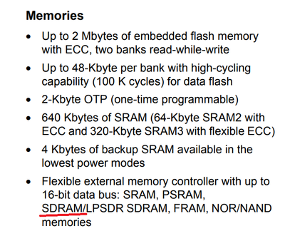

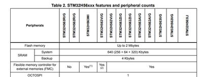

Hello @Mohamed Aymen ;
STM32H563/H573 devices feature FMC-SDRAM ;)
https://www.st.com/resource/ja/datasheet/stm32h563ri.pdf
STM32H533 doesn't feature FMC-SDRAM interface and it was a choice.
