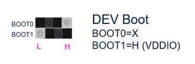

RomainR.
@wwnsok2, the capture you shared doesn't help.
Can you confirm you configured BOOT0 and BOOT1 switch on STM32N6570-DK as the picture bellow:
Then, press one time on NRST black button, LED2 Red must be ON and it confirms that STM32N6 is in DEV_BOOT mode. After that you can start a debug session.
Best regards,
Romain,
I proceeded with that mode, but I still get the same output result.
